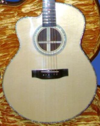

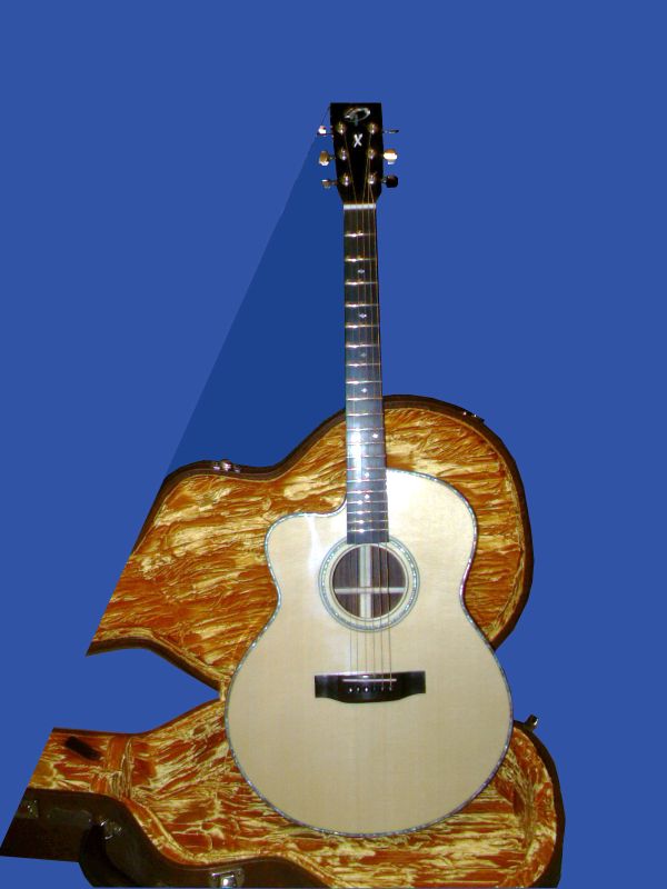

Okay, here's the guitar with the broken file removed and strung up! (The guitar, not the file!)!

Very nice recovery Is it really a lefty or did you reverse the picture?

Well Done Larry.
Whats the little symbol on the headstock under your Logo ?

Sweet is that a OLF SJ if so you did the same cutaway I use. bigger softer radius. a lot safer to bendMichaelP38875.7130671296
PostPosted: Wed Jun 07, 2006 8:33 am
Very nice, except, of course, the cutaway is on the wrong side. Probably fix it with a file.

Don, it's a Lefty!
Russell, the "X" signifies the 10th guitar I started...a couple were finished and delivered in the meantime...
Michael, it is an OLF SJ, and I did wimp out a bit on the cutaway just to be safe...

Burb, I went with the upper caul with a hole in it, glued a chunk of ebony with a depression to catch the file end onto a deep throat clamp, said a short prayer, and put the squeeze to it...sounded like a cannon going off when it popped out...got my inspection mirror and checked the innards to make sure that the file was the only thing that came loose!

Larry, Glad you got that fixed, And no cracks to the bridge plate? Cool-WTG
Nice lookin guitar too

Thanks Dave! No cracks that I could see with the little mirror....

Mike, let me put those up when the pro photo guy gets a hold of it...this was a very quick and very dirty one with a cheapo camera just to show that there's no file stuck in the bridge!

Nice lookin Git Lar! I really like the abalone. Good that file came out easy!
